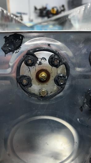

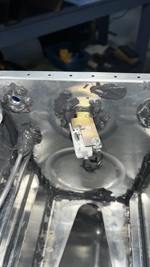

Brief Description:  Instaling the Inboard Fuel Level Sender
I also installed the inboard fuel level sender today after finishing the outboard one. This arm is bent according to the standard Vans manual. Sky Designs did not alter the float arm install for ER tanks since they are dimentionally the same except extending 2 rib bays outboard.
I know I will have to modify the electrical wiring for one of the senders to be able to run both to the senders to the GEA24 without any issues. I am beleiving wiring must be in a series configuration. I am still doing my research but I wanted to update my records accordingly.

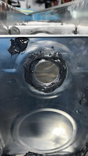

Again I used proseal on the threads, inside and outside the rib so no leak will be present (or so I hope).
