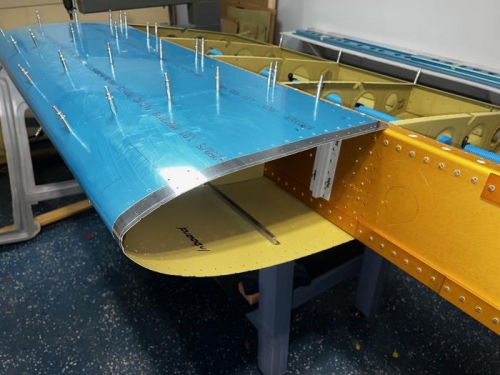

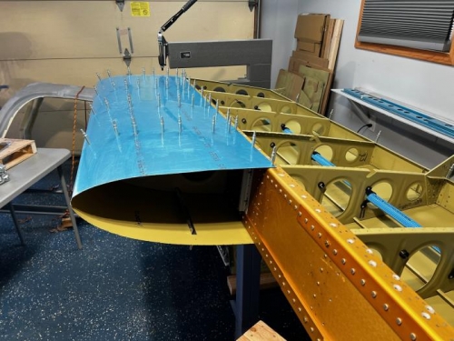

It was a nice and rainy Saturday so I stayed in the garage and made a very productive day out of it. SInce I can only attach 3 pictures per post I will post different ones to show.
This morning and early afternoon I clecoed the leading edge wing ribs to the skin and match drilled the J stiffener. I then clecoed the assembly to the wing spar for this photo opportunity.
I then did the same thing to the right side.

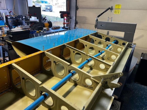

I am making SD ER fuel tanks so I had to trim 2 full rib bays of 1001 skin off. You can see in 3rd piture material removalwith no film,
