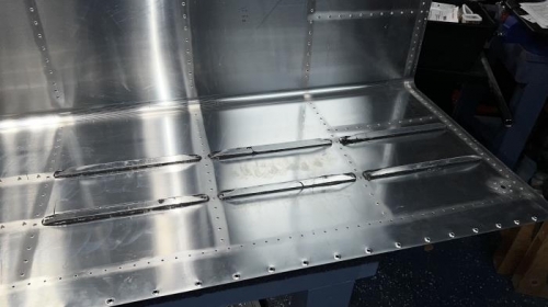

Brief Description:  Back Riveting Lerft Tank Skin Stiffeners
Started using proseal and it was not to difficult to rivet the left tank skin stiffeners. They all go the same way except most outboard aft stiffener which is facing the other way. Pretty straigt forward.
Manufactured heads are all liiking flush and clean.
Little squeeze out from proseal but acetone cleans it right up:-)
left ER fuel tank stiffeners prosealed

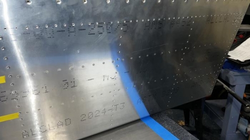

finished back riveting left skin stiffeners
