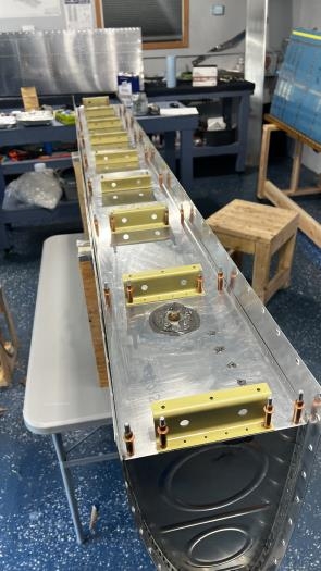

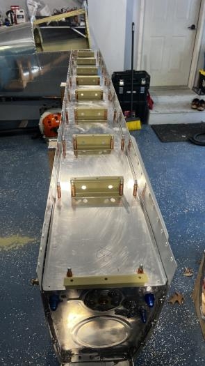

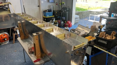

Brief Description:  Left ER Tank Rear Baffle Riveted Proseal
I pretty much followed the YouTube video by Scott McDaniels of Vans Aircraft with regard to prosealing the rear baffle to the rear flanges of tank ribs and inboard skin. I definitely used more on the corners which is a prone location for leaks. Please see pictures I have attached.
