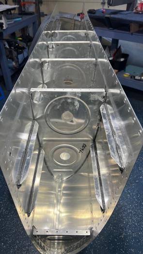

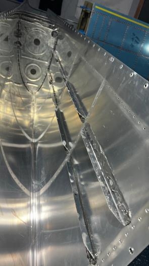

Brief Description:  Left Fuel Tank Stiffeners Prosealed Riveted
I started the day prosealing for the first time!!!!!!!!!!!!!! AREN'T I A LUCKY GUY:-)
I managed to get all of theLEFT tank stiffeners in place and backriveted everything! I purchased a 24"x24" 1/4" thick back rivet bucking bar made of steel. This was much easier than the smaller one I have from Cleaveland Tools.
I mixed just 2 batches of proseal so I would not have to deal with this stuff setting on me. It was a good work session. Besides it being really messy everything turned out perfect.
All of the manufactured heads of the AN4263-3.5 set perfect.
Before beginning, I previously scuffed the surfaces and taped the rivets in place in preperation for back riveting,
Small amounts of sealant on the outside of skin cleaned up nice with acetone and a rag!
Sorry if I did not get any pictures of the skin uncradled but I was hands deep in proseal. Did not want to get any of this stuff on my phone.
stiffeners riveted

stiffeners riveted 2
