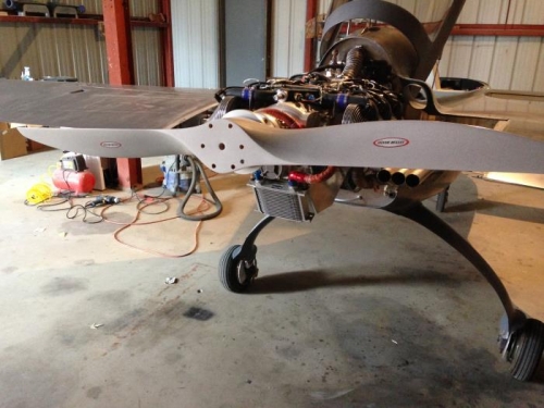

Brief Description:  Prop #2 Fail
Gary Hertzler is truly a fantastic guy, but these new high revving engines are not his turf. Nevertheless, He Drilled and painted a 3rd prop for me that is now on its way. This new prop will be 10" LESS pitch puting it at 62x68. He believes that I should get at LEAST 2600 Static Rpm on this one. The 62x78 that I got today would only do 2100 which is far lower than the recommended 2800 by UL Power. Again no cost to me, I'm just glad I get to be the experiment :)
P.S. Catto is cutting me a prop tomorrow as well. ;)
#2 No Go
