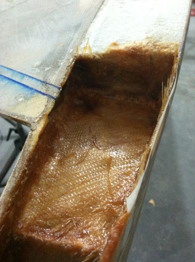

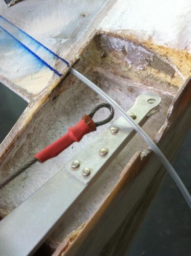

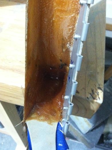

Lot of little tasks tonight. I cleared out the places inside the winglet where the rudder cable would rub during operation, then superglued the conduit in several spots for a temporary hold. After this I removed the rudder, made up one end of the cable, removed the cable, then closed out the winglet with 1 ply BID. The second task was laying of 2 plies BID over a Bed of flox that covered the rudder horn per plans.
