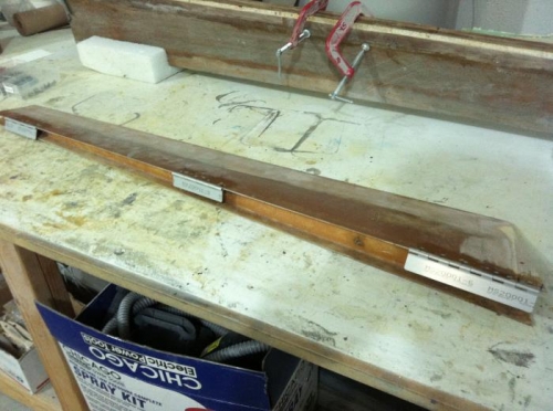

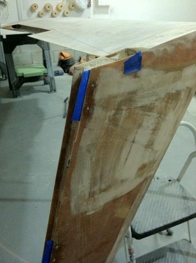

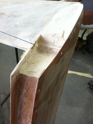

Brief Description: New hinges and flush rudder prep
The inside of the winglets' trailing edge was cleared out in prep for the internal rudder horn. At this time the previous builders screw holes were filled with flox and the new hinges were installed on the rudder half. The rivet work that was in place was fairly poor so the hinges were completely removed and replaced.
