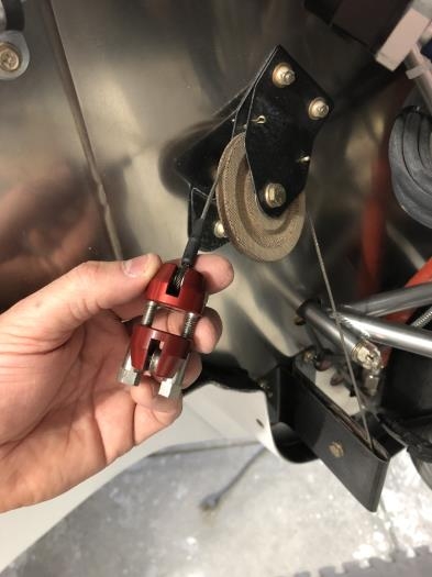

Brief Description:  All new Rudder cables
This birdy is getting all new cables. The rudder cable conduits have been upgraded so she gets all new 1/16 SS 7x7 cables to go with it. This time, moving the coupler inboard a bit to avoid the AP servo and giving all the ends clean cuts and heat shrink. No more bloody fingers!
