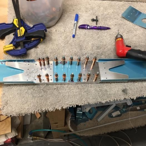

- Separated the two HS-00003 spar doublers and drew the rivet lines. Placed the two HS-702 front spar channels on the work table, end to end, with the flanges facing down. Clecoed HS810-1 reinforcement angle, HS-814-1 splice angle to the two HS-702 spar channels.
- Clamped the HS-00003 spar doublers to the HS-702 spar channels and Match-Drilled #30 the inboard holes shown. Then clecoed the doublers to the spar.

front spars and HS-00003's
