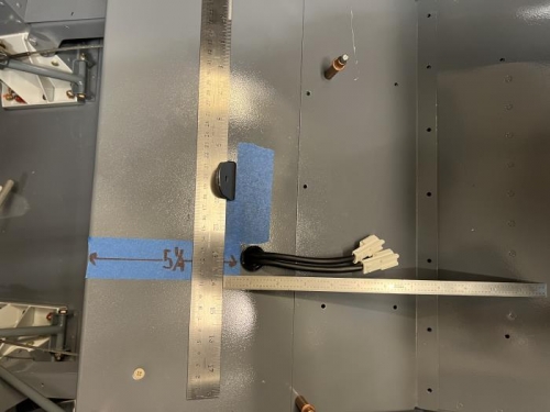

Brief Description:  Seat heat wire issues to resolve
I have a non-standard wiring approach to the seat heaters which has taken some back and forth with the kind folks at Oregon Aero. The seat heat wires and those big connections route on top of the seat pan which means I would be sitting on them and likely rubbing on them. This would be a wear-point for either the seat or the connection, so I was looking at having Oregon Aero work in a recess in the seat core that would create a pocket for the connections. OA said they could do it either way, but in the end, I decided it's better to adjust the wire routing to have it connect at the back of the seats where people normally do it, instead of messing with the seat cores.
