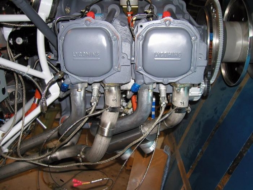

Left side, EGTs drilled and CHT battons and probes installed

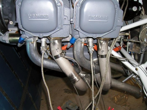

And the right side, same deal

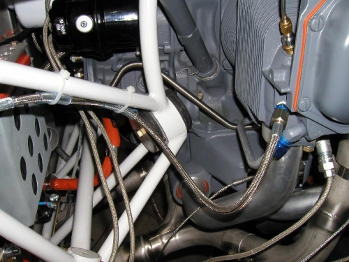

The manifold pressure fitting in the rear of cylinder 3
