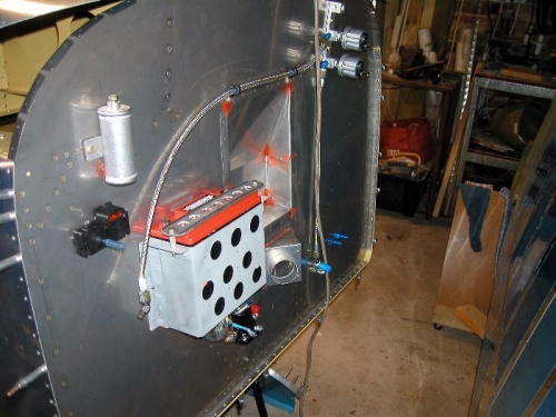

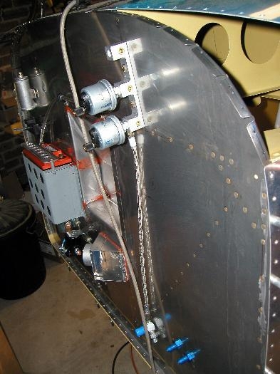

Brief Description:  Installed transducer manifold, riveted firewall re
Today I installed the oil and oil transducer manifold on the Fire wall and also installed the Dynon Manifold pressure sensor. I also riveted the forward fuselage ribs to the firewall and rear instrument panel assembly.
The top sensor on the manifild is for fuel pressue, you can see the line hanging over the battery, its held in place with two cusion clamps (adel clamps). The bottom sensor is oil pressure and its connected line is hanging strait down at the moment waiting for the engine to be installed.
I also sealed and riveted the firewall recess for the oil filter and constant speed gear if your installing it. All the gaps and edges were coated with High Temperature RTV before being riveted and then excess that oozed out wiped off.

Manifold pressure sensor to the left of the battery
Transducer manifold for fuel and oil pressure
