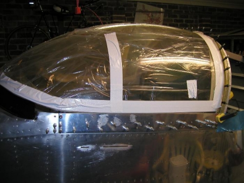

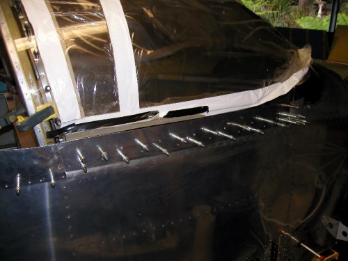

Today I just took it easy and marked, drilled and cut the side skirts to match the front and rear skins.
The holes for the screws along the top still need to be back drilled and then dimpled for #6 screws, but the canopy needs to come off for this to happen, so that will be a job for later in the week.
