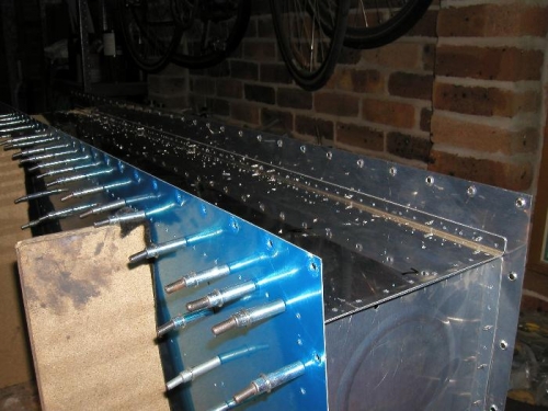

Brief Description: Dimple joint plate and tank skin

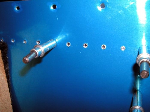

This afternoon before the mosquitoes became to bad I did a few prep jobs. The joint plate has been drilled to the correct size #19 adn dimple with #8 dimple dies. The bottom of the tank skin was also drilled to #19 and dimpled and one side of the tank skin to baffle plate attach area has been countersunk with a #40 counter sink.
I have ordered my next lot of Proseal and a few extra tank bind rivets for the Z bracket attachment, this should be here early next week I hope. The exchage rate and postage are killing me, Proseal and rivets came to about $40 USD and my landed cost is $130 AUD.
Bottom of tank skin dimpled
Tank skin countersunk where it attaches to the rear baffle plate
