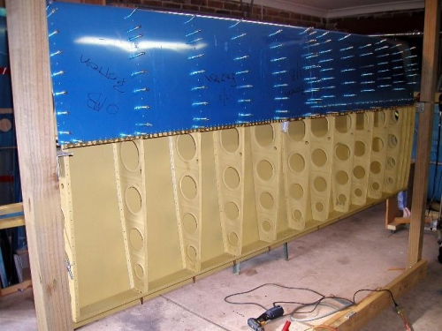

Ian came over to lend a hand setting up the tank i.e. clecoing the ribs into place, installing the 3 nut plates that secure the most inboard tank z bracket. Once this was done we fitted the tank and outboard nose skin. The joint plate between the tank and nose skin was back drilled.
Tank and outboard nose skin inplace for back drilling
