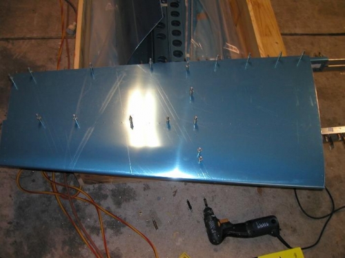

Brief Description: Prepare all horizontal ribs and fit skin
Straitened and fluted all horizontal ribs except HS-404 and HS-405. Assembled the front and rear spar with ribs and then fitted the left skin and marked the holes from the skin onto the ribs.
Horizontal skin fitted to allow HS-404, 405 to be marked for straitening and fluting
RIbs fitted and the skin holes maked onto the ribs
