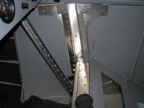

Brief Description: Install center spar and uprights

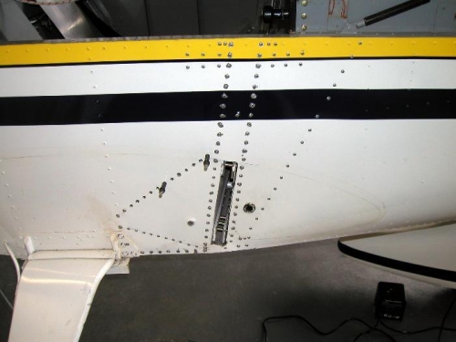

I need to touch up all the rivets with some etch primer and then apply paint, this should go a long way to hiding the beauty that no decorates the side of the fusealge.
Its pretty ugly, but its much much stronger.

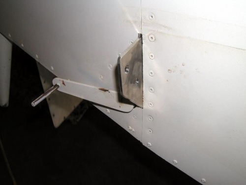

External view, not pretty but what can you do
I managed to instll the verticals uisng the original rivet holes and add the T doubler to the inside
