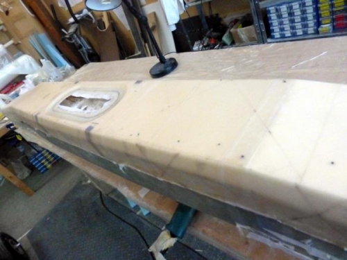

Nice straight fibers

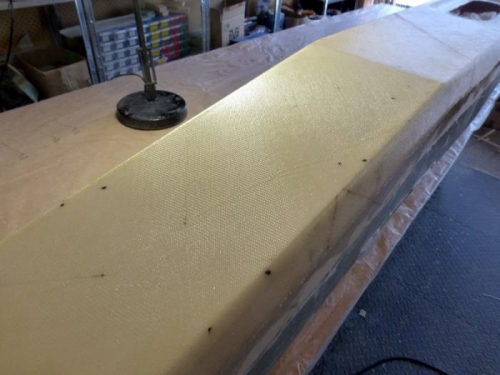

Looks best before the peel ply

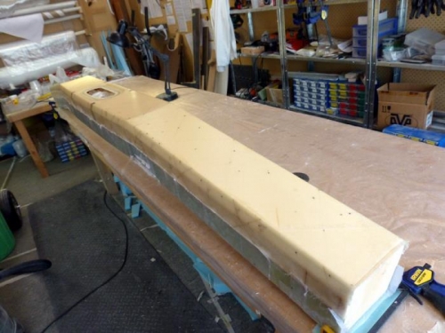

Done and curing
Done and curing
