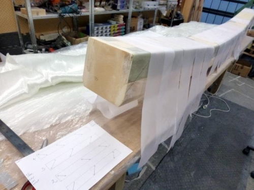

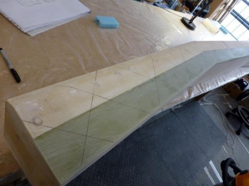

Brief Description:  More CS Spar sheer web prep
More prep work for the CS Spar outer sheer web layup. Now the surface is nearly good to go. I've drawn lines as a guide to keeping the cloth bias correct at 45 degrees. Its a lot easier when drawn although +- 10 degrees is acceptable according to the plans. The main thing is to keep the bias straight for maximum strength.

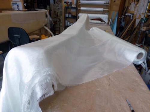

The second pic is laying out the pieces of cloth. Yes I over do this and cut way too much causing wastage. Early on I tried to save cloth and ran short on the job a couple of times. Its just not worth it so I end up with some spar scraps for small jobs. Not a big deal.
