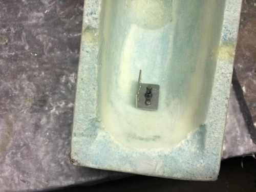

Brief Description:  Securing Landing Brake cover

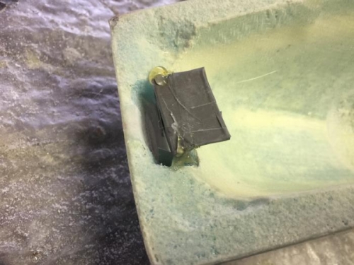

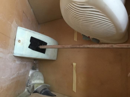

Just one of those little things that need doing. The landing brake cover has to be secured. I'm using a nut plate and positioning it with hot glue and a stick. Once floxed in place it peels from the release and another job is done.
As you'll see I use the foot rests later to further secure the cover. For now one screw in the right place is enough.
Nut Plate
Nut Plate
Positioned
Positioned
Fixed
Fixed
