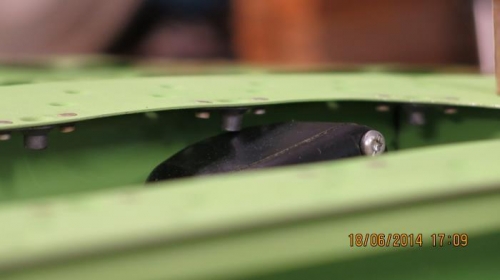

Dimpled the trailing edges of both starboard and port lower skins. Assembed doublers to the lower skin and fit into position. An anchor nut on the starbaord lower skin interfers with the flap motor.

Anchor nut interference
