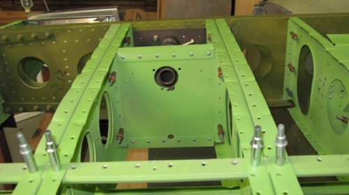

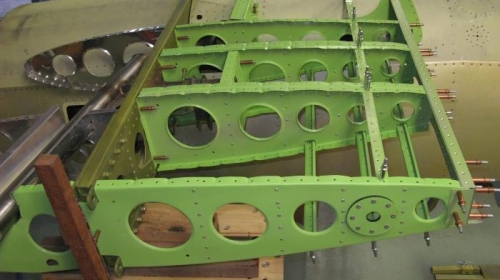

Brief Description:  Assembled starboard centre section components
Riveted rib pairs together with 1/8" rivets. Clecoed into position.

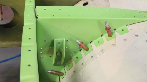

Assembled flap motor mount bracket and fixed to the inner rib with 1/8" rivets and an application of Sikaflex. I felt that due to several excess holes in both th rib and the bracket, extra strength would be warranted. Three holes which had been enlarged during initial assemble will be riveted with 5/32" rivets.
Fitted aluminium anlges for the MLG pivot and to ribs either side.
Fitted the ribs in position with 1/8" clecoes and the stiffeners with 3/32" clecoes.
