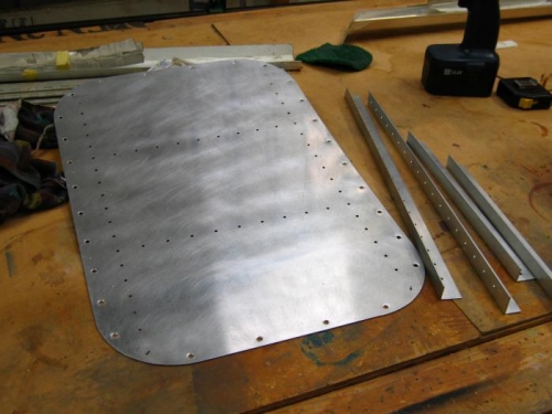

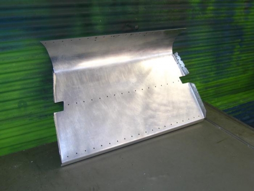

Match drill angles to 1/8". Fit seat base and bac k to drill 4 off 3/16" holes through back of seat base for anchor screws. Dimple part of top row (of seat base) to fit under seat back. Drill out seat base support to 1/8". De-burr all holes and prep for priming.
Passemnger seat base prep'd
Passenger seat back prep'd
