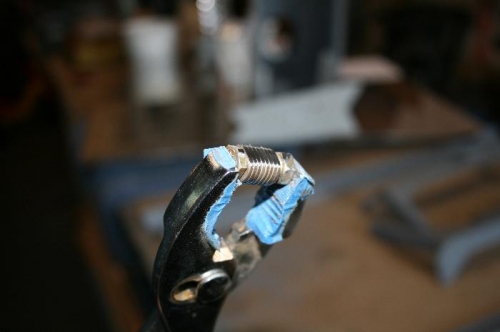

-Radiused the edges of 8 washer for bolting the forward and aft upper cross braces (allows the washer to set flat due to the radius of the corner angles).

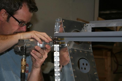

-Riveted the Forward upper brace (F-802N-1) and Aft upper brace (F-802T-1). Had good results as I was able to squeeze these).

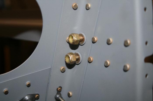

-Put all of the AN-3 bolts in for both items above.

Radiused washers on the bench grinder.
Squeezing the upper brace rivets.
Upper bracket locknuts and rivets (from the inside).
