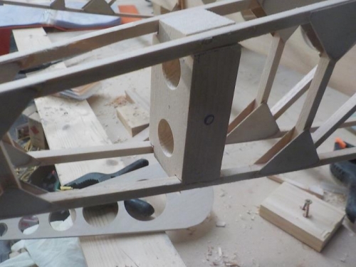

Brief Description:  Aileron hinge blocks

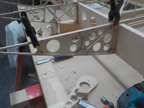

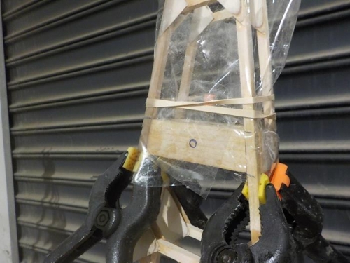

Built and epoxied in position all the aileron hinge blocks. 2 for the aileron end ribs (bottom of pic 1) and 2 for the outermost wing ribs.
Removed the required spruce strips from the wing ribs per the plans and strategically added lightening holes to the 1/4" plywood supports as well as the outer hinge blocks.
Lightening holes
Lightening holes
Outer block
Outer block
Curing
Curing
