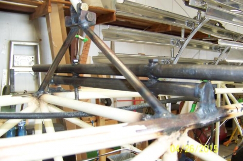

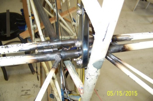

I put the recently sandblasted and painted tail surfaces on the airplane. Measured and restructured the rudder and elevator control cables. With the addition of a "plans connection" (omitted from our project) on the rear rudder pedal. This connection provides the connection of front and rear rudder pedals. I had to shorten each cable. I placed new thimbles and copper sleves for the correct length. I need to order one more barrel and fork end to complete the elevator cable.
Elevator control horn
Omitted connection part
