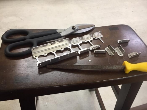

2. Cut out angle attach clips and filed edges smooth. Deburred all holes.

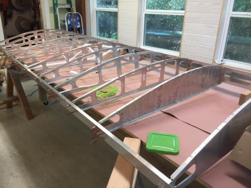

3. Clecoed ribs to front and rear spars. Four ribs are just curved too much. I will try pulling them off one at a time and fluting them to take out these curves and twists. Also the root rib top flange overlaps a little onto recessed area on D-Spar. I will have to adgust this.

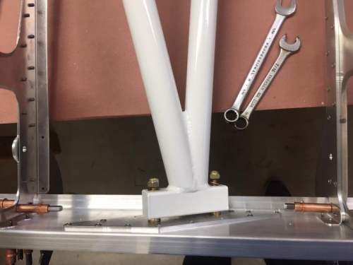

4. Bolted the truss to the rear spar. I used two thick and one thin 1/4" washers to fill the gap between spar and truss. Fits good.
Truss Connection to AFT Spar
Cutting out Angle Attach Clips
Left Wing Skeleton Clecoed
