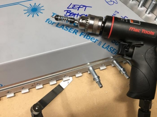

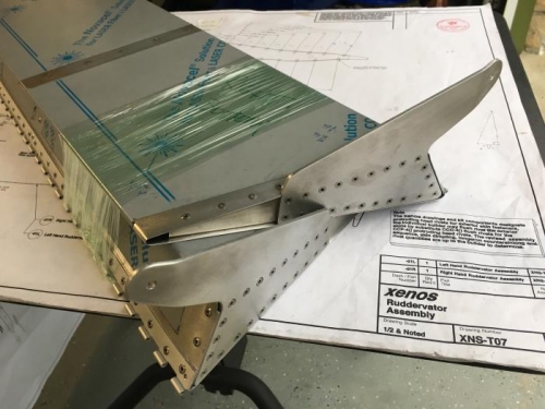

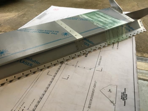

Completed drilling and deburing of left ruddervator. Aligned and riveted ribs, skin, and hidges. Inadvertently riveted left side hinge with end flush with outboard edge. Drilled out rivets and moved hidge to align inboard edge. The consistant one inch spacing due to the drilled aluminum ruler (see previous link) helped enourmously in dealing with the error.
Ruddervators complete
