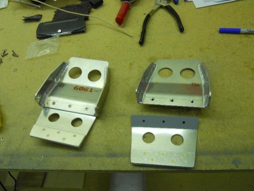

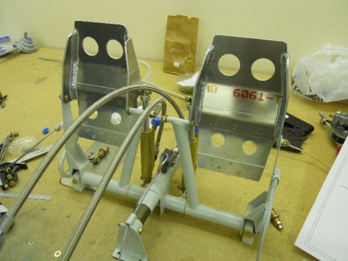

Finished up the rudder pedal extensions. Shot a line of primer on the extension where it overlaps the bottom of the rudder pedal. After the primer dried, I screwed the assemblies together, and then installed the pedals/extensions to the rudder/brake assembly. I also installed a brake cylinder return spring and collar on each master cylinder. Still need to add some cotter pins, then will be ready to install the assembly into the fuse and begin plumbing the brake lines from the reservoir.
Primered overlapping parts
Installed pedals/extensions

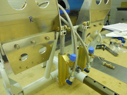

Rear view-notice brake return springs
